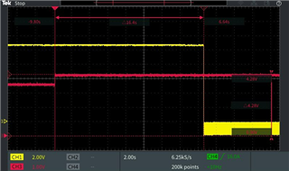

When I disconnect the communication, the COV delay time is no longer within the set range (delay set at 2 seconds, activates after 7 seconds). Additionally, it may require a higher voltage to activate (COV set at 4.25V, actually activates at 4.29V).
You can use an EVM board to verify this issue.

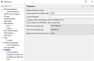

I see that even while communication is running, it is still greater then the delay. Would it be possible to run this test again while having the bqStudio log on, with a sampling rate of 1s (how to change this can be found on the preferences page below)? This would allow us to see how the gauge is processing this protection when triggered.
Anthony Baldino
Hi Anthony
This is a 1-second sampling rate. Do you have any other questions?
I don't understand why adjusting the sampling rate affects the Coefficient of Variation (COV). Please explain and give examples.

The changing of the sampling rate will not affect the current results, however when the log file is created it will give more resolution of what is going on within the gauge at this time. Since the default timing is 4s, it would be more difficult to truly determine what is going on within the gauge when the protection is triggered.

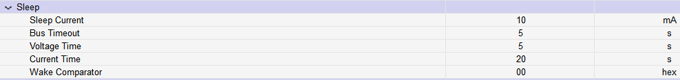

What is the current reading during this time? If you are trying to exit sleep, the gauge relies on the current reading to break the Sleep Current threshold. The Voltage Time dictates the sampling time between voltage measurements while the gauge is in sleep.
Anthony
The sleep voltage time setting is 1 second, and the protection is triggered in 6 seconds.
COV delay time is set to 2 seconds (range is 2~5 seconds), so 6 seconds exceeds the intended range.
When a customer uses the product, there is current consumption, and even without communication, there is enough current to break sleep mode.

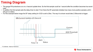

After receiving council from our team regarding this issue, firmware protections measure in intervals of one second, which in turn will add roughly another second to the trigger time of the protection. In the situation above where the gauge is starting in sleep, the device is required to wake up from sleep and enter normal mode at this time, then sample for the protection, hence why there is more time added to the delay.
More information regarding this can be found in the FAQ below:
