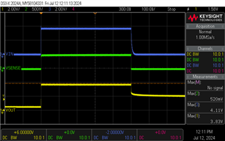

    Following is the waveform of Vin(blue trace),Vout(yellow trace) and Vsense(Vfb - green trace)) with a 500ms pulse drive duration.
    A current probe is not available I´m afraid for measuring the inductor current. The inductor is a XFL4020-152MEC with a saturation current of 4.1A. We expect some components to arrive start of next week for further testing and planning to test on an other similar board to confirm same performance behaviour.

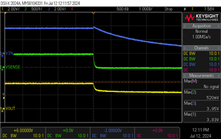

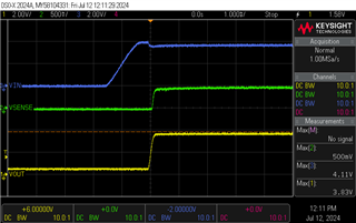

    Attached you will find a capture of the waveforms including the Vfb(purple) probing pin FB. Green trace (Vsense) probes on R36. In addition, the particular capture was at the same conditions as the one shown on my first reply i.e. input voltage, Rsense value.
  • Hi  Alexios,
    Thanks for confirming.
    Then, is it possible the actual resistance of  R36 is not 0.8?
    Tao

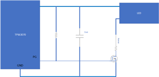

  • Hi  Alexios,
    I think i got your point and the possibility root cause should be the start-up logic of TPS63070.
    For TPS63070, device will limit it is input current limit to 1A before power good, which means, if FB voltage can not meet 0.8V*94%, device will always work with 1A input current limit.
    A possible solution as below.
    Tao
  • Hi Tao,
    Interesting. So your suggestion is to use the Power Good output to turn on the MOSFET and therefore the LED driver? What about the feedback pin?
  • Hi  Alexios,
    No change with the connection between Rsense and FB Pin.
    For the solution, what i want to do is make the FB higher than 0.8V before LED on, then, the input current limit should back to normal one.
    Tao
