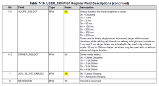

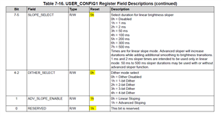

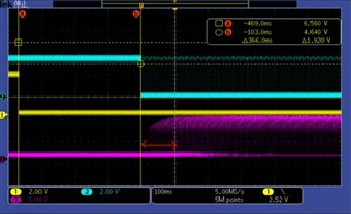

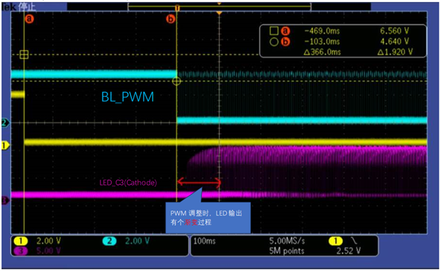

When customers perform PWM modulation on the LP8864, the output of the LED_C1/C2/C3 is a gradient buffering process.
对LP8864进行PWM调制时,LED_C1/C2/C3的输出是一个渐变缓冲过程。

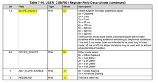

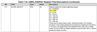

Can they change the register below to make the LED output immediately? How to change it? Also, are there any drawbacks after the change?
改下面寄存器可以让LED立即输出吗?要怎么改呢?另外改了之后有什么缺点吗?
 *Currently all are based on the default settings.
