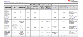

Dear Team,
PMIC datasheet suggests nINT pin should be pulled to VCCA which is 5V in my case. But it is connected to DRA821U processor EXTINTN pin which is 1.8V level. Since this nINT pin is open drain can I pull it to 1.8V instead of VCCA (5V). Is this violation acceptable.
Kaushal
