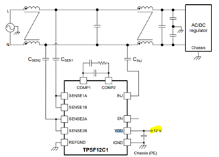

How is the VDD supplied to the AEF generated on the system? Generally, ACDC→DCDC (VDD=12V) is generated, so it seems that the filter does not work at startup. Does VDD require a power supply separate from the system power supply, such as a battery power supply?

    The bias supply for VDD must be chassis referenced just like the Y-capacitors shown in the drawing. Does the system have some kind of power up sequence before operation? If not, you will need a bias supply that is up during startup.

    In many cases, the power supply for the system is generated based on the ACDC. What kind of configuration is assumed for the bias power supply that is on at startup? There is no power-on sequence, but we are investigating use cases for using the TPSF12C1. Also, since these "bias supplies" are used on the primary side, they need to be Insulated, right?

    Usually, systems will have a power-on sequence to ensure proper voltages are set before initializing the system for operation. I am not sure what you meant by "what kind of bias supply configuration is assumed at startup" but usually there will be DC isolated voltage rail that is reference to the chassis.
    Yes, the bias supply needed for the TPSF12Cx has to be isolated from the primary side and referenced to chassis GND.
