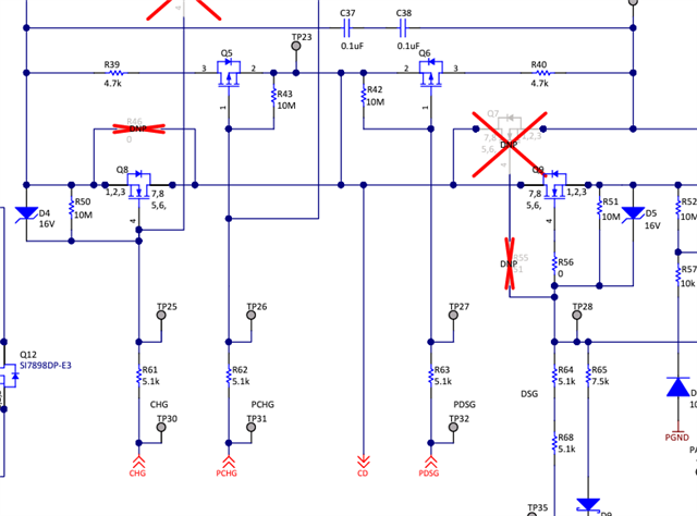

Hi evryone,
I am using the BQ76952 for my project of 14S battery with 150A DSG and i saw in the EVM schematics that TI used the 4.7K ohm resistor as current limitter
but in my project it is not enough i would be happy to get some help to figure how to use the PDSG and PCHG lines without burning the fets and lines.
(i was thinking about some current limitter or bigger fets and resistors but i dont know which kind and if it would help.)
much regards,
stas
