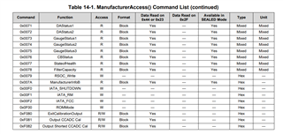

The customer is using BQ40z50R3.
When in sealed mode, why gauge still could be emergency shutdown and wake up?

Hello Fabio,
Shutdown is one of the few commands that are available even when sealed. The SBS commands section of the TRM should have all the available commands accessible when the gauge is sealed.
Siddharth
Besides, there is no any description about MFC command in table 14-1.
Please double confirm this.

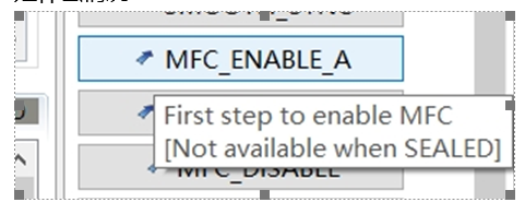

Hello Fabio,
BQstudio says Shutdown is available in sealed mode. I will look into the MFC Command and get back to you.
Siddharth
Hello Fabio,
MFC stands for Manual FET Control. The MFC ENABLE command can be used to let the user control the FETs, which can in turn be used to control Emergency FET Shutdown modes. This is not available when the gauge is sealed.
