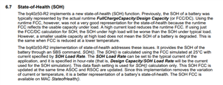

  • Hi Anthony
    Are there some updates, customers want to use the fuel gauge for battery health management, where battery life is currently calculated by dividing FCC by design capacity.
    Are there any other registers that can do this?
    Is that what our SOC says?
    I believe what you are referring to is the State of Health (SOH) register, where the device uses a value very similar to the FCC known as the SOH_FCC, and divides it by the design capacity to show the health of the cell. More information of how this is calculated for bq40z50 can be found below:
    State of Charge is the depiction of where the charge is compared to the current Full Charge Capacity measurement. At full charge, this value should be 100% while at full discharge the value should be 0%.
