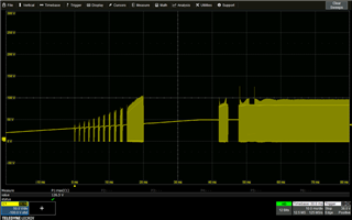

My customer found the MOSFET issue during the startup.
Boost uses TI LM5122 (Input:-48V, Output: 80V). The wiring is as in the attachment.

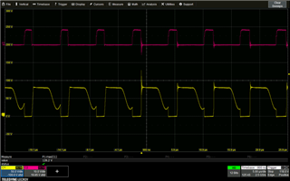

Currently, in factory production, Boost MOS breakdown occurs during startup. Some abnormal waveforms have been measured as follows.
Vds waveforms
Vgs and Vdc waveforms
And please help to check the schematic and Layout, thanks.

    Looking at the waveform, this hiccup behavior may be related to the softstart time and not a malfunction.
    If a very short softstart time is chosen, the device may trigger overcurrent protection during startup, which resets the device, leading to a hiccup behavior.
    My first suggestion would be to increase the softstart capacitor (C35) until the device can start up with a smooth, continuous ramp.
    For the second picture, I assume customer is concerned about the strong voltage overshoot.
    I cannot say just now why only one strong overshoot occurs while the switching looks normal before this event.
    If they see continuous overshoots of the switch note, they may try increasing the gate resistance or adjust the snubber values of the RC filter (R18/C13).

  • Hi Niklas,
    The Customer had an LLC after the LM5122, and we found that output dropped when the LLC started at 72V.
    We fine-tuned the comp pin C36 but no more improved. and I checked the schematic, and the MODE pin was flooring. should we pull this to Vcc?
  • Hi Rock,
    The LM5122 will always start up in DEM mode, independent of the MODE pin connection. Once startup is finished, it will switch to the according setting.
    If MODE pin is floating, the device will run in DEM mode per default. You can connect the MODE pin to VCC to set it to FPWM mode to check if the behavior improves.
    However, this will not affect the hiccup behavior at the ramp up, as this should be related to the softstart itself.
