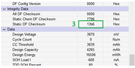

The customer is using BQ40z50R3.
When they are making the Mass-Production file, they do nothing about the three Checksum.
Just keep the default value.
Is there could be any problems or risks?
Hello Fabio,
The All DF Checksum is changed automatically when one of the dataflash parameters is changed. The Static DF checksum does not affect normal operation, so customer can leave this default.
