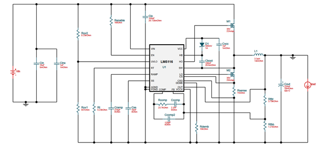

I have created a 12V to (-5V) inverting converter using the LM5116 on Powebench. However, when I build and simulate the recommended design in TINA-TI, I get the "Convergence problem, check analysis parameters".
Here is the schematic and the simulation file:
LM5116.TSC
How best can I simulate this without getting an error?
Thank you.
  • Hello Nyasha
    The TINA model is modelled for typical buck topology.
    If you'd like to simulate inverted buck-boost configuration.  Please configure the converter as a normal buck converter, and supply the input supply voltage between the drain connection of the high-side MOSFET and the power inductor output.
