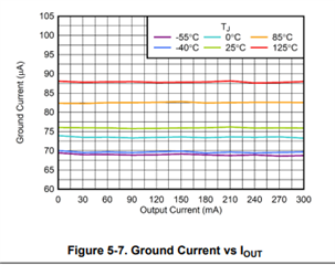

Hi team,
Ground current is constant even if output current increases as shown below.
Why is this?
I believe that as output current increases, Ground current also increases.
And, what different between Ground current and Quiescent current?
BR,
