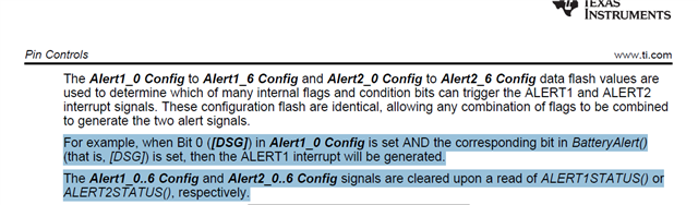

How to clear the interrupt signal on ALERT 1 and Alert 2? Based on the TRM, it says to just read the ALERT1STATUS(), the address is 0x5E/5F.
When i try to read the registers its giving me a vague values and I cannot clear the the ALERT1 signal. I try to use also the i2c master comm in the software but its not changing.

    • Enable Alerts:
      • Alerts are enabled via registers.
      • Alert1_POL is set to high (active), and Alert2_POL is set to low (inactive).
    • Interrupt Configuration:
      • Both Alert1 and Alert2 are configured to trigger interrupts when discharge (DSG) and charge (CHG) events are detected.
      • Once triggered, the interrupts latch and do not return to their original state automatically.
    • Current Situation:
      • After resetting the IC, Alert1 is low, and Alert2 is high.
      • When charging or discharging, the interrupt triggers, resulting in Alert1 pin going high and Alert2 pin going low.
    • Issue:
      • Reading registers 0x5E and 0x5F does not clear the interrupts.
      • The status remains with Alert1 high and Alert2 low, indicating the interrupt is still active.
    • Connection:
      • Alert pins are connected with 100kΩ resistors to VREG, as shown in the Evaluation Module (EVM) setup.
    What is the proper procedure to clear the interrupt on the BMS/Microcontroller? Is there additional steps such as writing to specific control registers or toggling certain bits to reset the alert pins?
