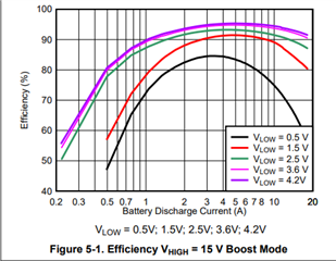

I am currently testing the TPS61289 on the TPS61289EVM-113 in boost only mode. The datasheet seems to suggest a boost capability of 2 to 15V above 90% at 8 A.
In testing I am seeing an efficiency closer to 75%, and with this efficiency loss a great deal of added heat. Are there any suggestions or tricks available to help get that boost closer to the efficiency above? Another possibly important detail is the voltage on the output seems to regulate too high. For example, the default setting on the dev. board is 15V Vhigh but I am seeing around 17.66V. Thank you for any help or suggestions.
