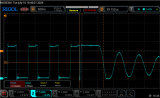

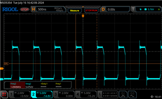

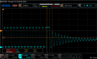

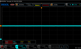

The problem I am facing is the following: after startup all 4 output voltages are correct with defualt vref (5.6V); when i change the vref value (to 48 decimal) buck 1 and 2 start behaving badly, while buck  3 and work correctly.
Correct working Vout adìnd Switching:

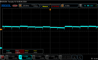

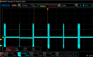

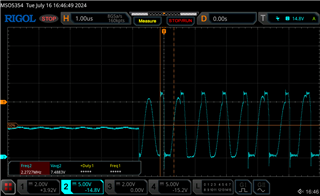

Here the capture of Vout and switching with 48 set as vref in the last test conditions
The Vout seems to be stopping every 20ms, this may be related to Output over corrent, but since there is no load I am not sure.
Is there some issue with the setting of the compensation components?

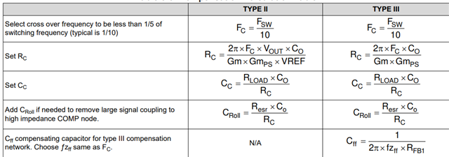

    (3) Choose the inductor: Typically, the value of L is chosen to have the ripple current be 0.1× to 0.3× the full-load current. I suspect you use the real load not the full-load current to get the value of the inductor. That might be the reason why you choose a 33uH inductor.
    (4) Compensation circuit

    4) I used the values calculated with Type 3 compensation of SW1 and SW2 in default config (Gmps 10A/V) for SW2:
    RC = 14kohm => 15kohm ; Cc = 39.99 nF => 39nF ; Croll = 21.42 pF => 22pF ; Cff = 8.9pF => 10pF

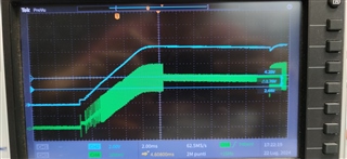

    Now with default Vref SW2 it works properly, also with 17 ohm load. But if we increase Vref, also with NO load, the bad regulation is present.

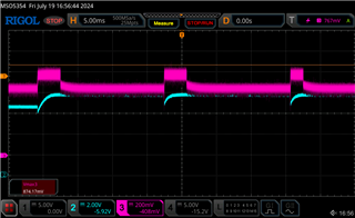

    Here is the Comp node (pink) in bad working (vout light blue):
    Can you explain me this behaviour?

    For the inductor, you can use full load current which is 4/4/2/2 for Buck1,2,3,4. Don't need to use the actual output current.

    Regarding Vout regulation, yes in the picture i posted Vout is set to 7.2V but it "losees" regulation and vout start moving.
    In the next hours i will provide more picture. Basically, the switching starts working where Vout has incresing behaviour, and then stop switching as COMP pin falls, al in last picture i send you.
    In my opinion it's a compensation issue, but i cant tell which is the cause. Do you think it will be helpfull to lower slope compensation?

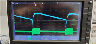

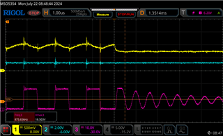

    Here I have fixed the output with resistor divider 120k 15k with defualt Vref. With my test i have seen no difference in output behaviour:
    Yellow : COMP ; blue : OUTPUT ; purple : SW
    Vout should be 7.2V but the output "moves" a lot.
    It seems that comp pin "stops" and due to this the switching is blocked.
