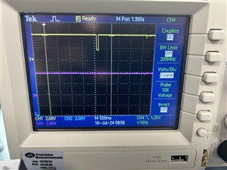

What we are seeing is that periodically the VSYS voltage drops to <2VDC this condition lasts for ~100mS
In some cases, VSYS is not affected at all, in other cases we have the dropout in voltage
This state has been verified by monitoring the VBAT input with a scope at same time we monitor VSYS: VBAT is not affected, VSYS drops out:

  • We have determined that the BQ24250C is going open circuit on connection between BAT and VSYS lines in response to a short circuit detection on the VSYS voltage
    This condition happens when VSYS drops below a voltage at which short circuit is detected.
    We need to know the value of the VREF_MINSYS and VMENSYS voltages (Refer to functional block diagram on page 15 of the datasheet)
    What we see is that the BQ24250C opens the connection between VBAT and VSYS for 70mS at this time.
    On page 10 the recovery time from an output short is 64mS nominal (controlled by the internal fast RC oscillator in BQ24250C)  Since upper and lower limits are not stated and the spec on the internal clock has 3.0MHz +/-10% it is reasonable that the 70mS we observe is this output short circuit recovery time.
    We have successfully induced this the volltage dropout behavior by applying an uncharge 220uF capacitor to the VSYS output and seen the chip respond by creating an identical short circuit pulse.
    The one remaining pieces of information we need to resolve this issue are the voltages at which the BQ24250 detects short circuit on the SYS output

    The short circuit protection is triggered if VSYS drops 300mV below VBAT.
