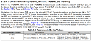

  • Hello Francisco,
    Snapshot from datasheet. Please refer to the table above about the switching load freq and current ripple. If your load falls under this, you can use TPS16412.
    I have overlooked the DC-DC converter load in schematics earlier. Apologies
    We value about customers and will continue to help with your applications.
    Can you fill in your system requirement in below design calculator and send. If possible, share your extended schematics (input side) and PCB for review.

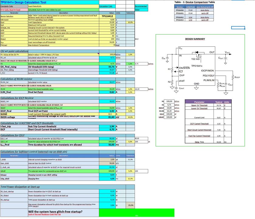

  • Hello Amrit,
    If you had a private discussion line we would be able to share further details and schematics but since you only have public forums we have limited information we can share with you.
    Our DC/DC switching frequency (fsw) is set to 500kHz and ripple load current varies depending on the input voltage which varies from 60mA (lower input voltage) to 180mA (higher input voltage).
    We have observed that all of the issues, when we saw the spark and the TPS16416 got damaged (yesterday happened to myself), always happened when the bench power source was connected to a voltage between 20V and 30V. We also often test the PCB between 10V and 14V and in that voltage range no one had issues.
    Checking carefully your screenshot, we can notice that the TPS16416 should be able to be used in all cases.
    Check the calculator screenshot. Please note that our current design is the one showed in first message as we modified the resistors of the voltage divider to match the values we prefered
    I kindly ask you to push this case and get back to us faster, as waiting one day for every answer is delaying a lot our ability to fix this issue.
    Thank you
