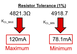

    It might be best to show you this with an example. The TPS1H000A-Q1 has a current limit accuracy of the following:
    So say we want to set the current limit to 100mA. We would first calculate the "ideal" current limit using the following formula:
    VCL(th) and KCL are constants in the datasheet and are 0.8V and 600, respectively. If we calculated for 100mA, this would give us a RCL value of 4.8kOhm, which we would put to 4.87kOhm to match a standard E96 1% tolerance resistor.
    The +/-20% number gets factored into KCL:
    Taking these values, you back calculate the minimum/maximum current limit values using the 1% resistor tolerances:
    As long as you are using the +/- % accuracy numbers listed in the datasheet, this accounts for temperature and process variation. We are also making an Excel calculator to make this a bit easier to to calculate.

  • Thank you for the example. As I expected, Rcl tolerance impacts the overall threshold according to the equation. Also it is good to know that the variation of 20% is due to the Kcl factor. Thanks for this clarification.
