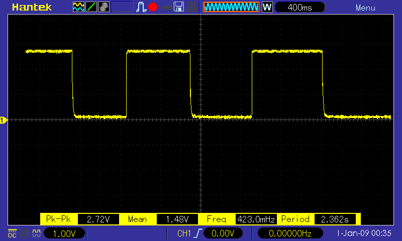

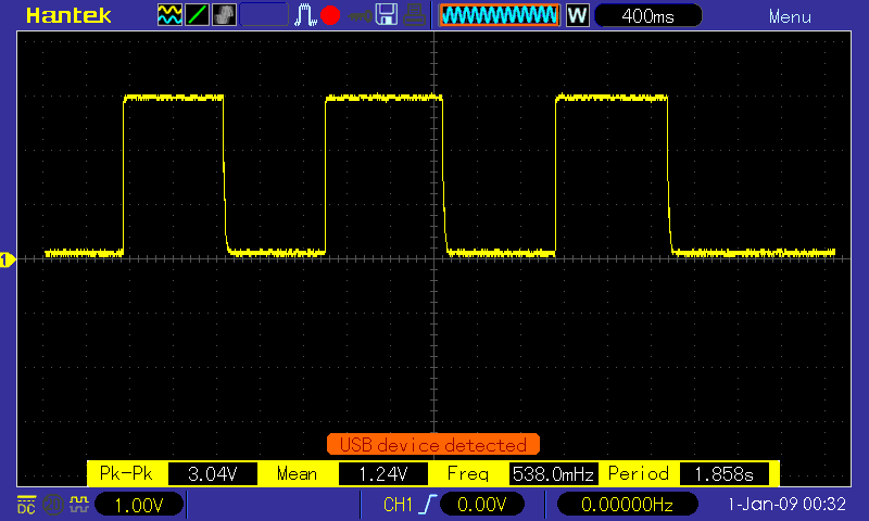

  • Hello Jackson,
    Firstly, thank you for your fast and extensive response.
    The description you comment about the LOW BATTERY LED activation circuit is exactly how it works.
    The phenomenon of possible leakage current in the LOW BATT signal occurs in the entire range from 4.1V to 3V. If it is true, it is visible that the lower the voltage, that is, the closer it is to those 3V, the greater the current leakage.
    I'm attaching the scope captures of every point you told me. The voltage drop on R5 is 1.75V for a BAT+PULS of 3.6V.
    Any other information required please let me know.
    Thanks a lot for your help.
    BAT+PULS (Each pulse is a press of the button that enables the voltage in BAT+PULS)
    CATHODE
    REF
    What I am looking for is to see if there is any abnormal leakage going through the cathode of TL431 as BAT+PULS goes on and off. I'm not seeing this from your scope captures. In my lab, I am also not seeing any abnormal leakage current.
    I have one follow up observation: As the BAT+PULS turns on, it will pass through the voltage range (0V to 3V) where the LED would indicate a low battery. If this is the case, I would imagine that the LED could turn on for a very short (ms) period of time as the BAT+PULS signal passes through the low battery voltage level, until 3V is reached when it would turn off. This same phenomenon would appear when turning off the BAT+PULS voltage, as the voltage will drop below 3V and then pass through the low voltage levels, allowing the LED to turn on, until BAT+PULS reaches 0V and the circuit is finally turned off.
    Basically, the point I am trying to make here is that I believe TL431 is behaving as we would expect it to behave. Since there is a rise time on the order of maybe 10 ms to 50ms (observing from your scope captures), there will be a window where the LED could turn on, due to that gradual rise. Does that make sense? Here is a diagram to show what I think is happening:
    However, in the voltage range where the low battery LED should not activate I see a small flashing of the LED mainly when pressing and releasing.
    This would explain why the LED is only flashing when pressing and releasing. If you disagree with my analysis, please let me know, but in my opinion, TL431 is behaving as expected.
