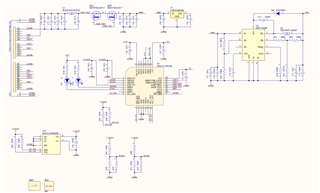

    Can you share a schematic and .json files?

    I give you the schematic and the json file. The device is configured in safe mode.

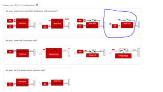

  • Hi Stefano,
    Can you draw a block diagram of what you are expecting? I need to better understand your system. Your schematic only shows on PD controller and a HV -> 5V buck.
    How are you supplying the higher voltages?
    Issue #1 is that your config is only set to source 5-V. If you look at the configuration you selected, you only have the 5-V internal path selected for source, and only have the high voltage external path selected for sink.

  • Hi Chris,
    Attached you can find the block diagrm of the system which is composed by two block that I posted before.
    The two board of the system shares the PPHV and the ground, The first system is powered by an adapter and I can plug more system one to the other.
    I selected the last configuration because I don't have a battery charger IC and I don't know how to choose a different source.
