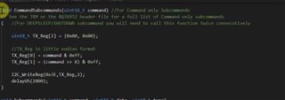

I have created a circuit board using the exact same schematic as the BQ76942_2Layer_TestBoard circuit. What should be my first step to configure and wake up the BQ device? I want to query the Device Number by writing to address 0x0001 at device address 0x3E with an external MCU, and then read from address 0x40, but I am unable to get the Device Number value. Do I need to connect a battery pack first? What am I doing wrong and what should I do? Thank you in advance.
