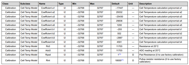

BQ27Z746: Thermistor Coefficients for Cell Model
Part Number: BQ27Z746

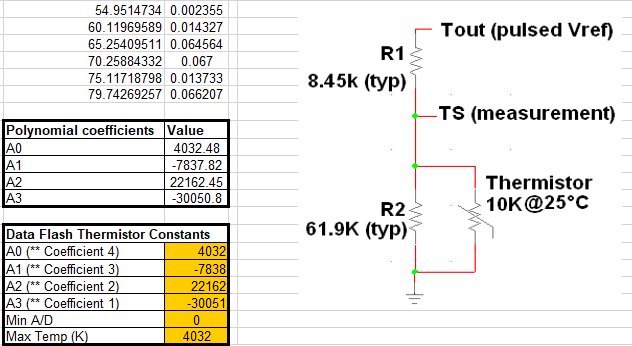

I am looking at the cell temperature model in the BQ27Z746 and cannot find details on how to calculate all 9 of the coefficients required for using a different thermistor.
The application note mentioned in the datasheet (SLUA621) and the accompanying coefficient calculator tool (SLUA398) seem to be for older gauges that use only 4 data flash coefficients and a different thermistor circuit than the newer BQ27Z746.
