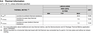

LMG3411R050: what is the power dissipation for LMG3411R050
Part Number: LMG3411R050
Do you know what is the power dissipation of the LMG3411R050? I can’t find it in our datasheet.
BR,
Gary
  • Hello Gary,
    Below is a section from our datasheet that lists thermal information about this device:
    From the image, multiple values for thermal resistance are listed, and can be used for power dissipation calculations.
    The unit for thermal resistance, C/W, can be used to calculate junction temperature for any given power loss on the device.
