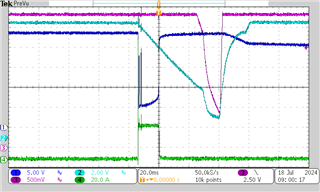

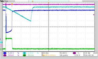

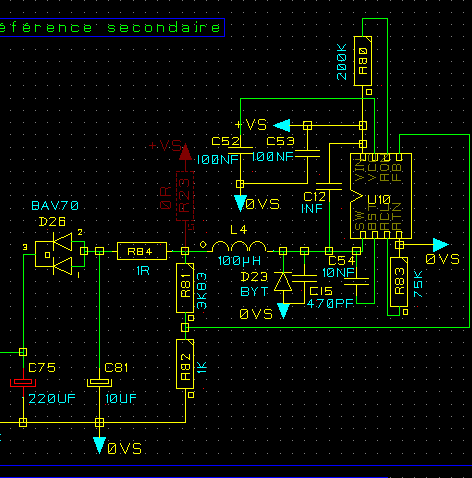

Dear TI team,
When short on board output, the Vin voltage is down for about 10ms, then recover following the fuse blow up.
However, the IC needs 40 ms additional to the 10 initial to recover. During this time, the output voltage drops constantly leading to board shutdown if not enough capacitor are installed on the output.
Why this 40ms/50ms delay on ? is there a way to prevent this ?
Please see pictures attached fo   you to understand the situation.
