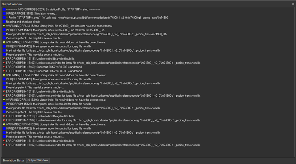

Hello all,
the LM74900 reference design shows some error.
Please can you send me an operational PSpice reference design or tell me how to fix this errors?
br,
Bernhard
Hello all,
br,
Bernhard
Hi Bernhard,
LM74900-Q1 Pspice model is not developed for Pspice for TI. It will only work in OrCad Pspice.
Sorry for inconvenience.
Shiven Dhir
