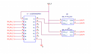

HI i am using ULQ2003A-Q1D for relay driver relay required coil voltage 5 i have enable digital card 6509 (5v) this circuit created ok
Kindly suggest.

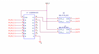

Kindly suggest.

Hi Shivaraj,
This looks good. Also, there's nothing wrong how you have it if each pin is providing enough current, but multiple output pins can be used to increase the current being supplied to the loads if required.
