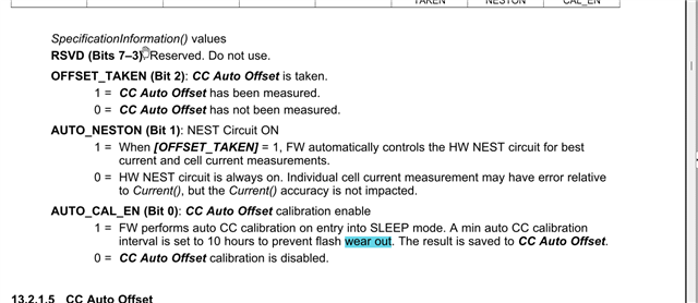

Need support how to diagnose the CC auto calibration function. CC Auto config is set to 0x7 (Bits Auto_Cal_En, Auto_Neston and Offset_Taken are set, see BQ40Z50-R3 reference manual chapter 13.2.1.4).
Based on this setting, an auto calibration should be done on entry into sleep mode (and sleep mode is being activated basically with no I2c communication no "present" signal).

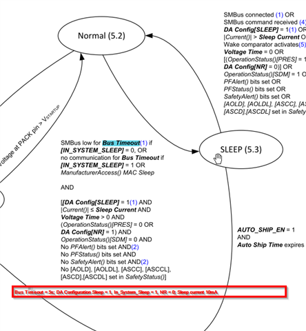

    Can you please confirm the device is entering sleep? This can be observed by attaching a scope to the TS1 pin of the device and looking at the sampling rate, where in normal this should be 1s but in sleep should be 4s.

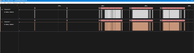

    - difficult to monitor TS1 pin (closed housing, only DC lines, SMBus communication and present signal accessible from outside. My assumption was/is that device will not be entering sleep mode as present signal is active and battery management studio shows connection active (SOC, voltage,.. are displayed) -> SMBus  communication is active; bus timeout is currently set to 5sec.
    Based on the SMBus signal recording (2nd screenshot below) I assume that the reason for the "going to sleep" is the bus timeout of 5sec (being too low); battery management studio is checking for a device with a cycle of ~7.2sec; if present is activated shortly after this polling, bus timeout will pass and BQ will go to sleep before next polling. In the test shown present was activated at ~13sec, immediatly after the 2nd poll cycle visible. When reading the data memory once battery management studio was connected I got 2 different calibration values -> auto calibration was done. I will check this with a modified setting of 20sec for the bus timeout.

    If bqStudio is also attached, turning off the auto-refresh will stop the constant polling to the device, which could also be keeping it out of sleep. Also, please ensure the current being read from the device is below the sleep current.
