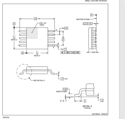

I have a customer with the below inquiry. Let me know what you think and thanks in advance!
"We are planning to use the LM5069MMX-1/NOPB on a 48V power rail. I am looking at creepage/clearance distances for safety. The pin pad spacing on this part is 8mils edge to edge. As I understand the standard, this spacing is not sufficient to satisfy the creepage/clearance distance. What am I missing?"
