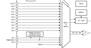

The customer said the Cell OVP/UVP will consume much time in their production line.
1. So the they want to know whether they could only test hardware OV/UV function for the first cell? Not all the cells.
2. When ADC is sampling TS/GPIO, whether the OV/UV comparator is still working? It seems that there is no MUX for the cell voltage monitoring?
When ADC is sampling VC1, whether VC10 OV/UV comparator is still working?
  • Hi Fabio,
    That's up to them to decide if it is sufficient to only test one cell.
    Keep in mind that the detection delay can be as low as 10ms:
    The comparator runs on a separate mux from the ADCs that runs much faster and can detect an OV/UV on any cell within as little as 10ms.
