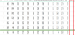

    Regarding the sent log file, are the Full Charge Capacity and Remaining Capacity values logged? I am having difficulty finding them, to which these will give us a better idea why the SOC is dropping at the end of discharge.
    Anthony Baldino
  •  Please check the attached images in these two columns.

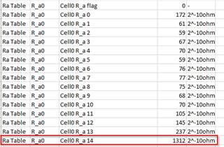

    Can you tell me what the formation of the cell stack is? Right now it seems like it is 3S1P, but the FCC value seems very high for that formation.
    Also, the Ra Table value at the end of discharge (#14) seems considerably higher then the rest, which could be causing this type of drop:
