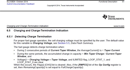

In TRM SLUUB04 6.5.1, Current Taper Window and Min Taper Charge are used in the explanation as known DF values.
However, I cannot find them in TRM or other related documents. I also could not find them in BQSTUDIO's SMBUS register or DF list.
Please provide the following information: class, subclass, subclass id, offset, data type, unit, min value, max value, default value, and description.
