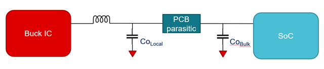

I checked and followed TPS62873 Datasheet and I think the key parameter is output capacitance.
If designed below sch. which ouput capacitance should we use for compensation's parameter?
 1) 47uF - Only capacitor for PWR IC
 2) 547uF - added Load's capacitor
  • Hi Jihoon,
    Thanks for reaching out to us.
    The TPS6273-Q1 datasheet (Sec 10.2.2) provides a detailed design procedure on calculating the required passive components (Lout, Cout) including the compensation values. The load transient specs need to be clear before using the calculation formula.
    On the other hand, the total output capacitance (near PWR IC + near load or SoC) needs to be considered in the calculation of compensation network (Rz, Cc, Cc2). You can also validate your design using the Simplis model (see link below). The PCB parasitic can be added in the simulation as well to have a more accurate result (see diagram below).
