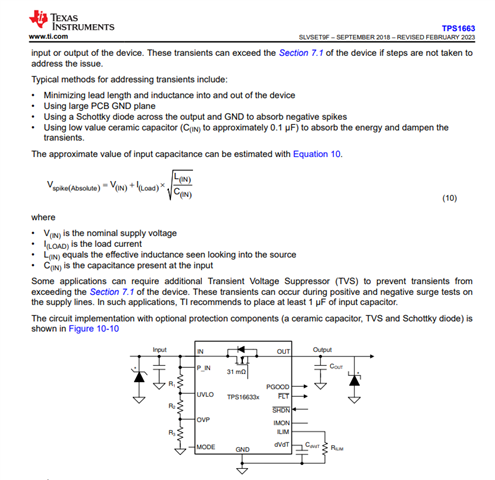

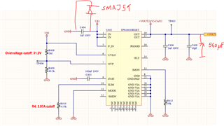

I am using TPS16630RGET  in an industrial automation application. The device operates at a nominal input of 24V with max possible input of 60V which is within the specs outlined in the TPS16630RGET datasheet.
During conducted emissions/immunity tests, surge and burst tests, when the input is connected via the LISN, the TPS16630RGET seems to go into a failure mode. I am not sure exactly why this is happening. Please help me out.
