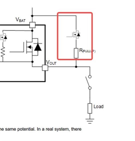

  2. Regarding the Iout(standby) question. Figure 7 can not help because VOUT=0V but customer real condition isn't 0V but 4V
    1. Customer will use the high-side switch in Standby and DIAGNOSTIC modes. Mainly in DIAGNOSTIC mode, the main FET is not turned on, but the internal 1M diagnostic FET is turned on, and at this time, they have a diagnostic structure like the figure below, which causes the VOUT voltage to be pulled up (about 4V). At this time, they want to know the leakage current at the IOUT end. The temperature condition is -40°C to +125°C . And the voltage is 9~18V and 18V~28V for two conditions.

    When DIA_EN is high the 1M resistor will act as a path to output in the system. The leakage is calculated by taking the 18V / 1M. In addition to this, when DIA_EN is high the leakage current will be the same but the current consumption in diagnostic mode increases (3mA) which will be added to that leakage value.

    The leakage current at the IOUT end. VBB=28V,VOUT=4V,diagnosic mode and standby mode.
    1. Condition 1: Voltage is  9~18V. Temperature condition is -40°C to +125°C .
    2. Condition 2: Voltage is 18V~28V. Temperature condition is -40°C to +125°C .
  • A short-to-ground will cause the device will enter the FAULT state. This will be available on the SNS pin This case is explained in section 9.3.1 of the datasheet.
    Working outside of the recommended operating conditions is not supported for this device. This was rated to operate for 12V automotive applications. There are devices that can operate at higher voltage levels like the TPS1HTC30-Q1.
    Condition 1 Leakage:
                    Diagnostic Mode: (18V / 1M) + 3mA = 3.018mA
                    Standby Mode: 18V / 1M = 18uA
    Condition 2 Leakage:
                    Diagnostic Mode: (28V / 1M) + 3mA = 3.028mA
                    Standby Mode: 28V / 1M = 28uA
