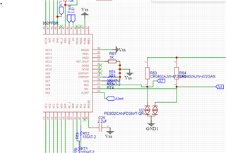

BQ76952: RST_SHUT pin effecting in EMI Test
Part Number: BQ76952
When Clamp is placed on Power Output lines i.e., P+ and P- in Bulk Current Injection Test ( BCI ), at certain frequencies ,I observed high logic voltage on the RST_SHUT pin, which is causing the Power interruption as well as communication interruption.
I have pulled down RST_SHUT pin to VSS with 1K resistor, Please help me fix this issue
Thanks & Regards
Mounish
