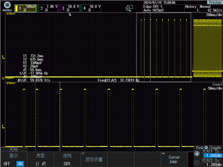

    We are trying to use watchdog within TPS65224-Q1 at Trigger Mode, the SOC is AM62A.
    We set the WD_WIN1 as 0x13 which means the Twindow1 time interval is 11ms.
    We set the WD_WIN2 as 0x4F which means the Twindow2 time interval is 44ms.
    We feed the watchdog 30ms later after escape the long window, then feed the watchdog per 55ms. But the Watchdog reset the SOC only serval hundreds ms later.
    The waveform of the trigger pin showed as below. The upper half of the figure is the overview of the trigger pin, the lower half of the figure is the zoom view.
    Could you help us to solve this issues please?

  • Hi Xianti,
    Watchdog exits window2 immediately when it has detected WD trigger. There must be at least 11 ms delay between the pulses to pass window1 but no more than 55 ms. If the delay is 55 ms the pulse arrives at the very end of window2.
    Could you reduce the time between the pulses to less than 55 ms, for example, 40 ms?
    BR,
    Samuli
  • Hi Samuli
        We feed the watchdog per 40ms, it work properly.

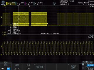

        Another question, we start to feed watchdog(escape long window)  at 1s later after MCU start up. In this case, after watchdog reset AM62A, AM62A will power up properly sometimes.
        If we start to feed watchdog(escape long window) once MCU start up. In this case, after watchdog reset AM62A, AM62A power up properly every time.
        What is the cause of this issue? The long window time interval is 8s, window1 time interval is 11ms, window2 time interval is 44ms.
    Best Regards.
    Xianti

        Watchdog works at Trigger mode. AM62A generated the trigger pulse at MCU_GPIO0_23, this pin connected with GPIO2 of PMIC.
    3) I do not understand your working case and your not working case. I assume you did not mean to say "escape long window" for both cases?
       The long window interval time was set as 8s.
        Working case:  After initial the watchdog, MCU generated the trigger pulse immediately, then MCU fed watchdog per 40ms. In this case, after watchdog reset AM62A, AM62A power up properly every time.
        Not working case: After the watchdog is initialized for 1 second, the MCU generates a trigger pulse,  then MCU generated the trigger pulse per 40ms. In this case, after watchdog reset AM62A, AM62A will power up properly sometimes.

  • Hello Nick
         We use R5F (MCU Channel) to generate trigger pulse.
         After MCU start up every time, we disable and enable Watchdog, then this issue has been solved.
        So the cause may be the long window interval time is about the time MCU started up, so long window time out sometimes when MCU warm boot up.
