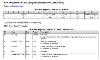

Since TPS631013 is a device with I2C feature, device actual enabled when register internal configured correctly. So, please help to check the status of register 0X02.
Tao
Hi Sanjeet,
It is make sense now. For TPS631012, device is default disabled as screenshot below.
Tao
Hi Sanjeet,
Yes, that is correct for TPS631012, but for TPS631013, device is default enabled internal.
Tao
