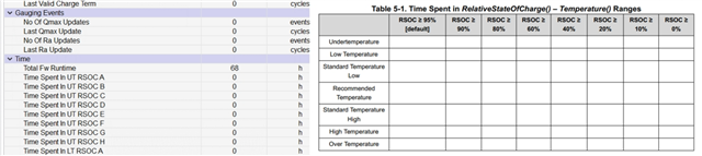

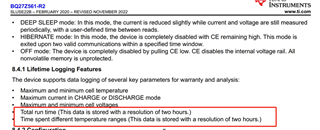

1. The TRM description is resolution of 2 hours, but why GG reads 1 hour and 3 hours?

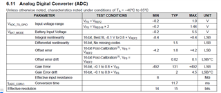

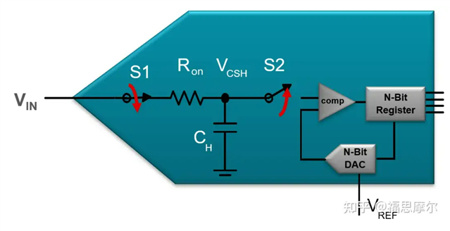

2. How long does it take for the temperature change to be written into DF? Is voltage and current the same?
Whether it is the same as the ADC conversion time or the sampling time?
If it is related to the sampling time, could you give an estimate time?

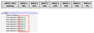

3.How does ROSC correspond to A~G in lifetime?
Whether >%95 is A and >0% is G?
