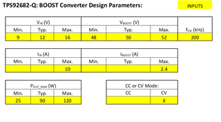

    Can you give me more details about your design specifications.  I need to understand each buck output channel specification and I need more information about the boost converter specifications.  I also need clarification about what you wrote previously.  Specifically, you said the 682 support 10A, what do you mean by that?  Are you saying max input current, are you saying it has to support 10A on the output of the boost?  You also don't state the parameters for the boost converter such as output voltage and max output power.  Please specify the folllowing for the boost:
    Generally speaking we will not be able to support much more than 120-130W using the TPS92682-Q1 in a 2-phase boost.
    I think it is important to specify all your buck output requirements.  You will also have to determine what is the max output power at one time, that will help determine what power level is needed for the boost converter.  Furthermore, we need to know the number of LEDs, the output current range, the Vf ot the LEDs used to determine min and max output voltage, and we will want to know if you guys will be doing shunt fet dimming or PWM dimming.  We will want to know PWM frequency and duty cycle range.  Each channel should be defined, and in your case that is 10 channels (5 dual channel bucks).
    Here is an example of the kind of information that will help us determine how to help you best.  I broke out all the channels in the system and then define input and output parameters along with other important factors:  I doubt all the channels will be on at once, so you need to figure out the worst case output power.  Let me know what channels are on and what the input and output conditions are for that worst case max output power.  You said each channel is outputting 1A, but is that true and if so what is the output voltage range for each channel?
    I have some power calculation tools I can give you but I want to understand your system better.
    -fhoude
