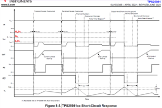

TPS25981: After overcurrent >2x ILIM / short circuit (=Fast trip) the device tries to switch on after 30µs even if we have the latch function
Part Number: TPS25981
Problem with eFuse TPS25814LRPW
  • After overcurrent >2x ILIM / short circuit (=Fast trip) the device tries to switch on after 30µs even if we have the latch function
  • If the short circuit/overload further exists the current is limited to 1.5A and the device waits for a thermal shutdown – because oft he good connection to our PCB this point will never achieved. The output voltage is in this case in an undefinded value of about 2.5V instead of 3.3V. Attached devices shows undefined behaviour because of this wrong voltage.
What we need if 2 x ILim > Inow > ILIM (=Overcurrent):
If current limit is exceeded for a certain time, the eFuse will completely shut down and disables output voltage until a new power cycle is started (Vin off and on).
Is there an eFuse which will do that at Ilimit approx. 1.5A and Vin=3.3V?
Andreas

  • Hi Arush,
    our sink draws current (for what reason ever, probably the FPGA is defective ) at startup > 2xIlim. Then we see the fast trip condition with current limit mode.
    What we want is, that in this case the device also completely disconnect Vin from Vout, because the thermal shutdown in current limit mode will never occur on our PCBs (thermal connection is to good).
    Regards, Andreas

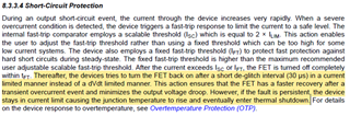

  • Hi Andreas,
    The device will perform this restart after FFT with 30us delay by design. This is present to ensure any issue like false transients don't cause system down. In your use case, it looks like the FFT is happening and afterwards the device is not performing the TSD due to less power dissipation on the device. I don't think there is any unexpected device behavior happening here.
    The only solution which I can see here use PG signal to externally stop the device. The PG signal will be low during this current limit startup.
    This delay was my mistake. I apologies for that.
    Arush
