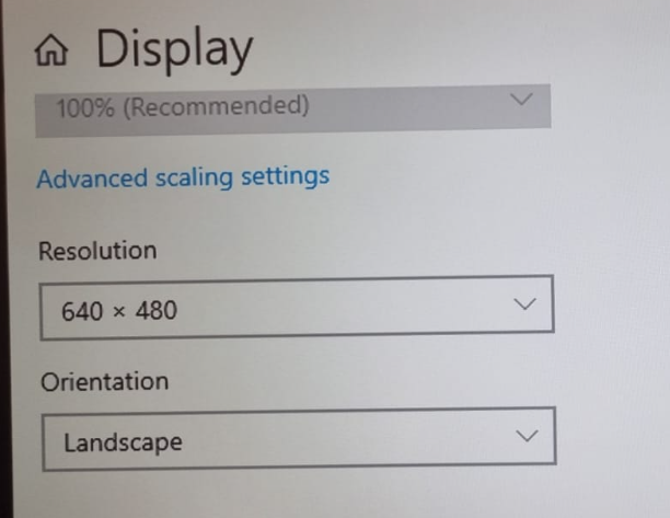

Im trying to run POC before implement the IC's in my system.
The setup:
DP Driver: PC.
DP to USB converter: TUSB1146EVM
USB to DP converter: TUSB1064EVM
For some reason, 640X480 is the only resolution the PC recognize, no matter how much im trying to change the JMP's settings (the first setup was as mention in the user guide).
I don't have high speed scope to measure the signals.
Any ideas ?

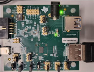

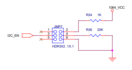

  • Thanks for reaching out. Can you check the jumper settings on the TUSB1064 EVM and make sure they match the settings shown below:
    I see that your I2C_EN setting (JMP5) has the board in I2C mode. Since this board is designed for GPIO by default, you should pull I2C_EN to GND using the jumper wire shown in the image above.

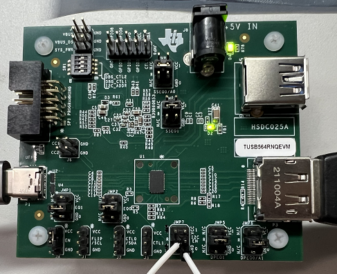

    I see some changes you should make to your 1146EVM jumper settings that may fix the issue:
    1. Can you change the I2C_EN jumper (JMP4) on your board to setting '0'. This would be GPIO mode, which is the default for this EVM.
    2. I see you have CTL1 pulled down on JMP18. This will disable video mode on the 1146. You should remove the jumper on JMP18 as well as the jumper o JMP17. JMP17 is the FLIP bit which will be set by the PD controller on the EVM automatically (no jumper needed).
    3. Please also remove the Jumper on JMP19. This is the USB data enable and will be set by the PD controller on the EVM automatically
    4. Remove the jumper on JMP16. This is the HPDIN signal, which needs to rise to 3.3V for our device to pass video correctly. Right now the jumper you have on it will keep it pulled to GND.
    Make these changes and see if the EVM works correctly. If it does not, check whether HPD is going to 3.3V on JMP16. If HPD is not going to 3.3V, you can connect a jumper wire to drive this high externally or by connecting it to a pullup header on the board.
    If HPD is going/is driven high and you still don't see a signal, pull up CAD_SNK using a jumper on JMP20. This will disable AUX snooping and ensure all DisplayPort Lanes are active.
    Here is an image of the board with HPD driven high and CAD_SNK pulled up. You can follow this image on your own board to see if it works. I've just tried this in the lab and was able to pass higher res video data.
    Shane

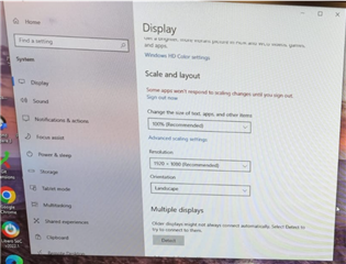

    The HPD signal goes high.
    When I’m using the 1146 alone, for some reason it works with your settings, beside JMP24 that should be in high to work.
    When I connect the 1146 with the 1064, the maximum resolution I can display is 1024x768, 60Hz. Each EVB works fine with 4K 60Hz.
    So, the USB and the DP cable probably works. It seems like the recognition process cannot be finished.
    I have one screen (Lenovo) that I can get the maximum resolution of the screen (1920x1080 60Hz), but on my 4K screens (LG/Sony) and even on simple full HD screen (HP) the maximum resolution i can display is 1024x768 60Hz.
    Please advise.

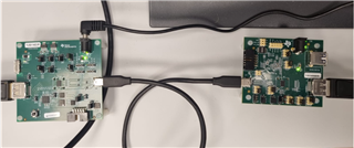

  • You may need to adjust the EQ settings on both boards to get a clean signal through. This would be DPEQ0 and DPEQ1.
    On the 1064 board: JMP5/6
    On the 1146 board: JMP10/8
    I'm able to pass 2560x1440 @60Hz video through both boards with the settings I showed previously. My DisplayPort cable after the 1064 board is rather short, but the USB-C cable and DP cable before the 1146 are both standard lengths.
    Can you adjust the DPEQ settings on both boards and see if the signal gets better?
    Shane
    After a few tries, i was able to pass 3840x2160, 60Hz, using standard DP cable, and short USB cable.

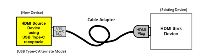

    1064/1146 components, in that case will it be possible to use them for HDMI transmission?
    Its possible to use the TUSB1146 in the source-side of an HDMI alt-mode application, but there is no place for the TUSB1064. Let me explain:
    The HDMI alt-mode spec defines a source-side HDMI to USB-C connection. This is where the TUSB1146 can be used with a PD controller that supports HDMI alt-mode (see 546 resource for details). I am not aware of any TI PD controllers that support HDMI alt-mode, so you would need to find this device somewhere else.
    There is no definition of a sink-side USB-C to HDMI connection. HDMI alt-mode requires a USB-C to HDMI cable adapter in the signal path. You cannot use a USB-C to USB-C cable in this type of application:
    Because there is no sink-side USB-C connection, the TUSB1064 wouldn't work. You would be better off using a dedicated HDMI re-driver on the sink device instead of a USB-C redriver/MUX like the 1064.
