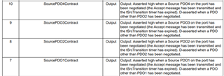

I am evaluating the TPS25751EVM for my project, which provides 5V/3A, 9V/3A, 15V/3A, 20V/3A, and 20V/5A PD source. Based on the TPS25751EVM design, the input power is drawn from the 751_PPHV net. How can this input be adjusted to match the above power settings accordingly? For example, can I use some IO pins to adjust my buck-boost feedback pin?

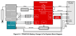

Additionally, we require USB-C mux control from the TPS25751 GPIO pins. Do you have any reference designs available for this?

    You can configure the GPIO pins of TPS25751 to toggle if a specific source PDO is negotiated, see screenshot below:
    You can use these GPIO events to change the FB pin of the DCDC to go to a specific voltage onto 751_PPHV. Another option is pairing TPS25751 with one of the supported BQ devices. TPS25751 contains internal firmware to control the BQ part via I2C and does not require any extra configuration besides the few questions on the GUI questionnaire page.
    We do not have a reference design with a USB-C mux, you can refer to the high-level block diagram below. There are also GPIO events available to be configured on TPS25751 for connection, cable orientation, USB2, etc.
