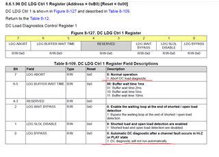

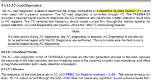

With PBTL configuration on 3&4 output (capacitively coupled) and an output pair not connected, how would the the device proceeds to Play mode if the DC or AC diagnostic is turned ON by default and test for open load?.
Is their a way to not test or bypass for open load during DC diagnostics?
  • Hi Jose
    In register 0xB0. Abort DC load diag could stop the start up load diag. Bypass DC diag could stop the automotive diag when device leave Sleep mode.

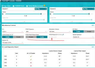

    I have the TAS6584EVM with me and playing around with it with BTL mode and it is working perfectly with PPc3 and my own I2S  micro generating sine wave for channel 1. When I have configured to PBTL as per PPC3 "IO configuration" and shorted the J11 +1 and -1pin /  +2 and -2pin  and put the a 2ohm load across the J11 combine pins of 1 and 2, I couldn't make the board output the sine wave that I have successfully done on BTL mode. I did also reduce the PVDD < 14.4 volts to ensure that I don't need external schottky diodes to perform this PBTL and still with no success. I have now couple of question below.
    • On BTL I only transmit on the left channel and just disregard the right channel. On PBTL, do I need to transmit in the opposite of the left channel? Can I just transmit left and right channel exact data and manually adjust channel 2 to 180°?
    • If I chose PBTL on channel 1 and 2 does the delay enabling to play channel 1 and then 2 on "Device Monitor & Control" I believe is causing an issue. Does the PBTL channel should have one consolidated control to sync both channel for proper operation?.
    Jose
    If successfully configured into PBTL, CH 1/2 will have the same PWM phase, and CH3/4 will have the same PWM phase.
    I think maybe you missed a part in the datasheet, that PBTL using requires to follow a correct sequence, as below.
  • thanks for the tip. I will use the sequences switches S1-S4 on the board to comply with the configuration sequence that you have attached..
