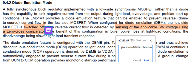

HI
In testing customer's board, customer found that in the case of DCM (DCEMB is chosen) light load, the wave form of the SW illustrated the unstable operation of the LM5143, in order to understand the cause of the occurrence, Tell me more about the working mechanism of Diode Emulation Mode,such as what condition will turn off low side MOSFET to implement Diode Emulation, and having a diagram will help me understand.
