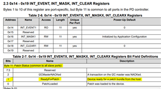

    Thank you for the clarification, unfortunately as you mentioned if TPS25750 doesn't boot from Dead Battery mode (VBUS is present before VIN_3V3) then the AlwaysEnableSink mode does not apply. When TPS25750 is in PTCH mode (regardless of the DB flag), the registers on the PD are not accessible since it doesn't have a valid configuration loaded.
    Is it possible to use the TPS25750 IRQ pin to indicate to the EC that the PD is waiting for a patch? I think this would be the quickest way for the EC to determine if it needs to load a patch when installing the battery.

  • Hi Raymond—thanks again for your continued support. We can easily detect whether the TPS25750 idles in patch mode from our second-stage bootloader, but that information is not actionable at that stage, because we are trying to avoid moving the TPS25750 patching sequence into this part of the boot sequence.
    Just to double confirm—are there truly no writeable registers from patch mode? I confirmed that the read-only POWER_PATH_STATUS register (0x26) is at least available:
    0x0d: 0xf8 0x19 0x00 0x00
    0x0f: 0x00 0x05 0x09 0xf5
    0x14: 0x00 0x00 0x00 0x00 0x00 0x00 0x00 0x00 0x00 0x00 0x02
    0x16: 0x00 0x00 0x00 0x00 0x00 0x00 0x00 0x00 0x00 0x00 0x02
    0x18: 0x00 0x00 0x00 0x00 0x00 0x00 0x00 0x00 0x00 0x00 0x02
    0x26: 0x00 0x00 0x00 0x00 0x00
    0x2d: 0x30 0x03 0x60 0x02 0xa1
    What we're ultimately hoping for is a writeable version of this register (internal or otherwise). If this functionality indeed does not exist, then I think we'll adopt option (3), which is to forgo checking Vbat against Vmin if POWER_PATH_STATUS is zero, then "limp" into the kernel at which time the TPS25750 is patched.
    If the battery dies before this point, the TPS25750 will boot into dead battery mode during the next restart anyway, so this workaround is probably OK after all.

    Unfortunately there are no configurable register/bitfield when TPS25750 is in "PTCH" mode. Typically in most use cases once the PD is powered on (either through VBUS or VIN_3V3) the system EC will load the config as soon as possible.
