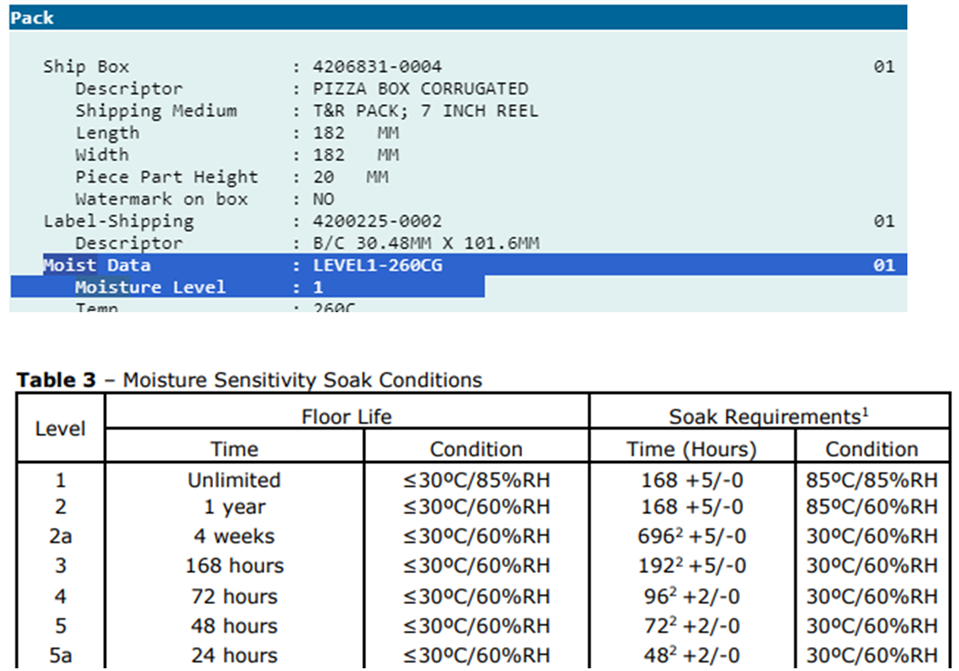

When you went from MSL2->MSL1, were any reliability tests performed?
If so, could you please provide the data?
Also, shouldn't the packing change (ZVEI: SEM-PS-02->B) be made to PCN?

Is there a document somewhere about the packing specifications when the dry packs run out?
I'm not sure if this document is available. Is it a standard document? have you order it before?
Mahmoud-san,
We have not had any requests from customers for packaging specifications without dry packs, so we do not have them.
This time, contamination of leadframes occurred at the customer's plant, and the customer considers the removal of dry packs as one of the possibilities, leading to a request for packaging specifications.

A customer had an additional question.
Customer's concern about moisture barrier pack removal has not subsided.
1. Please submit evaluation results (SAT) confirming that peeling due to moisture
absorption is not a problem after the moisture barrier pack has been removed.
(Customers are also concerned about terminal oxidation due to moisture barrier pack deletion)
2. Therefore, please submit evaluation results (e.g., photos showing wettability) confirming
that solder wettability is not a problem after the moisture barrier pack is removed.
