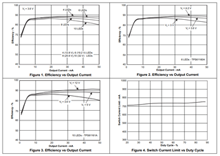

Would it be okay to set Rset to 2.5Ω and use the CTRL-pin to adjust the LED current from 0 to 80mA?
All of efficiency vs output current graphs(Figure 1 to 4) in the data sheet are up to 50mA, so the customer is concerned about whether there will be any problems using it at 80mA.
