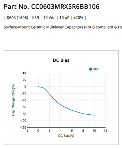

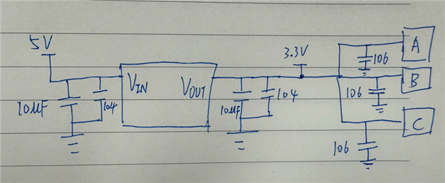

My customer use LP5907-Q1 for MCU and some devices power as below, the total capacitors are up to 40uF and the PN is CC0603MRX5R6BB106:
1. As shown in datasheet, the output capacitor limit to 10uF, I wonder if it's valid value in 3.3V or nominal value.
2. What may happen if we use 4pcs 10uF capacitors at LP5907 output? Will it be less risk if the length from output PIN to device A/B/C is long enough?
3. Shall we need to reduce these 10uF capacitor?

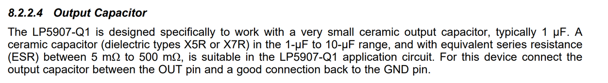

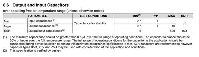

    As described in the datasheet, for all voltage options, the maximum output capacitor value for which the device is guaranteed to be stable is 10uF, given it also meets the ESR requirements. This is assuming the fact that the capacitor tolerance should be 30% or better over the full temperature range (as described in the footnote of section 6.6).
    The LP5907 has a risk of becoming unstable and oscillating with higher values of load capacitance. The risk remains the same for different lengths. You can test the stability of the LP5907 with this much Cout by using an EVM and placing your actual Cout onto the EVM and conducting a load transient or NISM test. Just letting you know, this is not a recommended operating condition for the device.
    10uF Output cap is the max value with which regular operation is guaranteed by the datasheet.

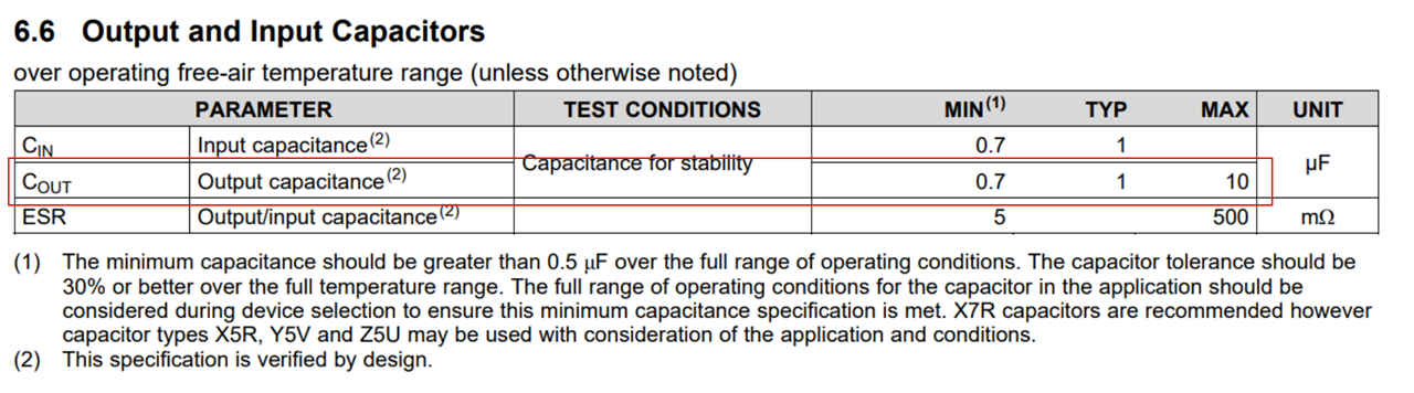

  • Hi Bobby,
    Thanks for your reply, as we can see from the datasheet, when the output capacitor is working under 3.3V DC, valid value is only half, about 5uF.
    As shown in datasheet, the output capacitor limit to 10uF, I wonder if this limition is for valid value in 3.3V or nominal value?
    Jack
  • Hi Jack,
    Sorry, I misunderstood your question earlier.
    From datasheet, the max 'capacitance' the device is guaranteed to handle at output is 10uF.
    This means not the nominal value, but the actual capacitance (de-rated) value at the point of operation (3.3V in your case)
    Bobby
