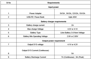

We are designing a power delivery system with TPS25730D PD Controller, BQ25638 Battery Charger and BQ27520 Fuel gauge.
Our requirements are as follows.
Kindly review our design attached below and provide your feedback.
