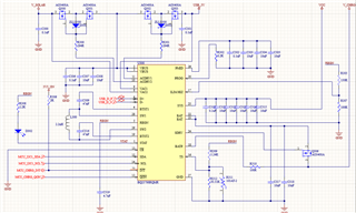

I am having a similar problem to a previous post on here but I have a 2 cell LiFePO4 battery arrangement (V_nominal = 6.4V, V_float = 7.2V) with a VSYSMIN of 6V. I want to charge these batteries using the BQ25798 off a solar panel with VOC = 21.4V and V_PMAX = 17.9V.
When I plug the solar panels in, it charges. But when I block light from the panels, the IC stops charging and wont reinitiate a charge cycle again for about 10min. Additionally, while the charger is in this state, I cannot set the EN_MPPT bit to 1 as it gets immediately reset back to zero. While the IC is charging I can set the EN_MPPT bit to 1 but once light is removed from the solar panel, it gets reset back to 0 and I cannot set the bit to 1 again until it starts charging. In this state, the EN_HIZ bit is set to 1. As this is for a power sensitive application, it is important that the charging IC is able to use the MPPT algorithm and can start charging almost immediately once adequate light is available.
The only ways to get the IC to start charging again is to either unplug the PV panel and plug it back in or set the EN_HIZ bit back to 0. Both of these solutions are not ideal. REG_RST does not reinitiate charging either.
When I initialize the charging IC I (in order), disable the watchdog timer and set VAC_OVP to 26V, Set the EN_MPPT bit to 1 and VOC_PCT to 0.8125, Set VSYSMIN to 6000mV, VREG to 7200mV, ICHG to 1000mA, VINDPM to 22000mV,  INDPM to 3000mA and set VRECHG to 300mV.  I will also note that after attempting to set INDPM to 3000mA it fails to set and will not set higher than 0x77 (1190mA).

Schematic is below:

  • Hi Ewan,
    If the input voltage falls below poor source voltage (essentially 3.6V), the charger auto enters HiZ mode for 10min and then retries.
    EN_MPPT can only be set to 1 if V(BAT)>MINSYS voltage, otherwise the periodic MPP sampling while switching is stopped would allow the system to crash.  It is not critical that MPPT be enabled during this time because the charger auto senses the input voltage and sets VINDPM to sensed voltage - 0.7V at power up.  The VINDPM voltage technically isn't the panel MPP but should eventually allow the charger to start charging and charge V(BAT)>MINSYS voltage.
    In short, the charger eventually comes up but it will make multiple attempts with 10 minute between each attempt.
    Jeff
  • Is there any possible configuration that would allow the IC to charge immediately rather than having to wait 10 minutes? It seems strange for a PV charging system to function that way as we want the system to be charging as soon as sufficient light becomes available since its so dependent on weather conditions.
    After a week of outdoor running we have also noticed that the charger will not initiate any charge cycle in days there isn't direct sunlight. We have a 15W panel attached to the IC which should be able to provide a small amount of current even on days without direct sunlight.
  • Hi Ewan,
    The charger's poor source detection pulls 12mA of current to see if the voltage falls below 3.4V.  If so, then the charger enters HiZ for 10min before trying again. If the charger passes poor source, then it tries to start up and pulls up to 200mA of current.  If that doesn't collapse the panel, then the charger can pull up to input current limit as set per the ILIM_HIZ unless disabled and overwritten by the IINPDM register. You might try setting the input current limit per ILIM_HIZ resistors to a low value.  Then let the host disable ILIM_HIZ pin and set a higher value IINDPM register once the sun is up. Even if EN_MPPT bit =0, the charger still has VINDPM function which tries to prevent input voltage from collapsing below the sensed panel open circuit voltage (Voc) less 0.7V, which is likely not exactly MPP but should eventually result in charging.
    Also, keep in mind that the optimal (MPP) VINDPM setting is only found when EN_MPPT bit =1 but EN_MPPT resets to zero if V(BAT)<MINSYS setting.
    Jeff
